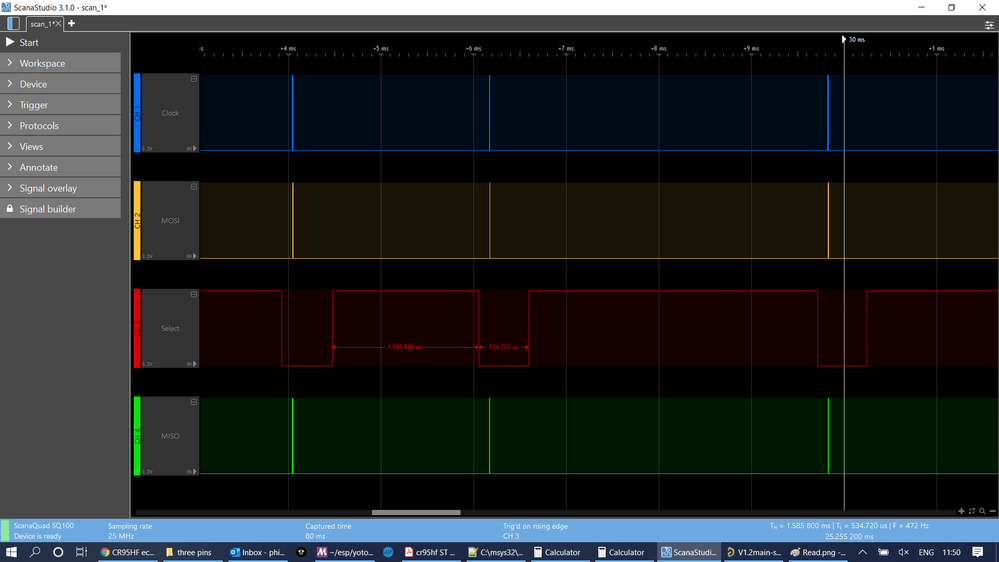

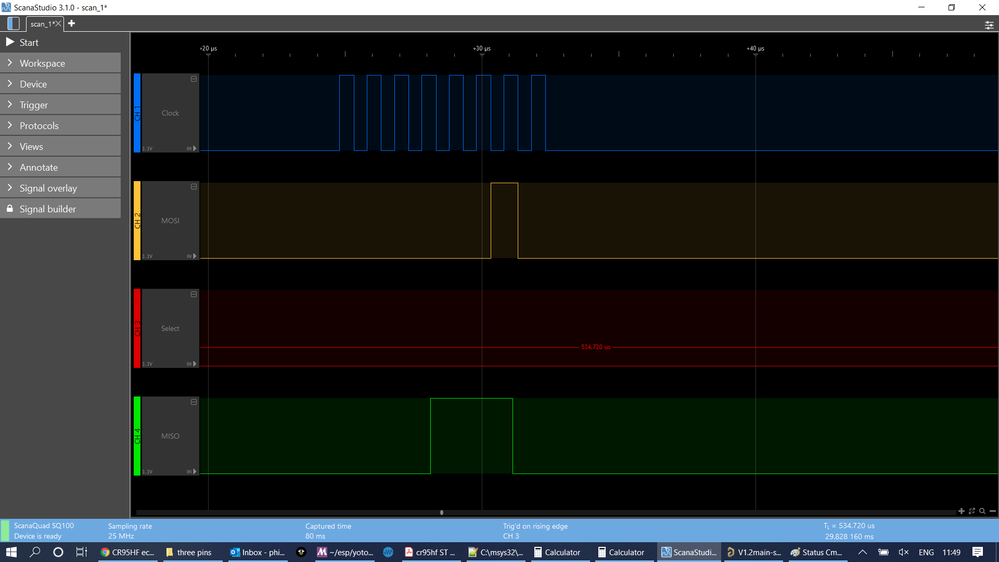

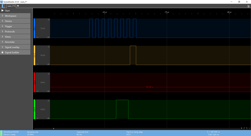

I have attached some screen grabs to show thw signals and theit timings.
When sending an echo command, :
1) is it two bytes ? 0x00 and 0x55, or just 0x55 ?
2) Is the length parameter 1 ?
3) is the rxlength parameter 1 ?
Thanks
Phil.
Reset command :
Echo Command:0690X00000ARErAQAX.png
Wait for status to change :
Read response (get 0x0e and not 0x55)
Overall summary :
Brian TIDAL
for your information, the X-CUBE-NFC3 v2.0.0 contains our portable NFC stack (called RFAL) and our ST25R95/CR95HF portable driver. This can be ported to non ST platform with minimum effort (a platform.h files is used to map SPI communication, timers and traces on the proper calls for a given platform). I would recommend to use the X-CUBE-NFC3 in order to reduce the porting effort.
Back to your question:
  • Is it really necessary to use IRQ_OUT pin or is the polling ok ? If you do not plan to use the Idle command, then you can use the 0x03 poll control
  • When sending an echo command, : is it two bytes ? 0x00 and 0x55, or just 0x55 ? The 0x00 control byte (Send) has to sent prior to any command
  • When sending an echo command, Is the length parameter 1 ? The echo command is an exception and does not have a Len parameter. Therefore, the following byte has to be sent for a complete echo command: 0x00 (Send Control byte) 0x55 (echo command)
  • When sending an echo command, is the rxlength parameter 1 ? What do you mean by rxLengh parameter? See figure 8 in the ST25R95 datasheet for the explanation about reading from the device:
    • send 0x02 control byte (Read), the MISO can be dropped, the data will start a t the next MOSI byte
    • send dummy bytes and read the MISO
This should solve you issue as you are reading the first MISO byte whereas it is should be the next one.
Rgds
BT
