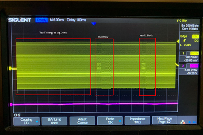

2024-01-08 5:09 AM
My device works with a battery. And I need to minimize consumption.
My antennas and pcb are not perfect. Tell me, can section "load" energy may be shorter? Now I can't do less than 30ms..
in the picture reading one block from tag.

2024-01-08 6:11 AM - edited 2024-01-08 10:40 AM
1. I use a special board
2. I output debugging information through the interfaces of the microcontroller that controls the CR
3. I'll check the messages the command returns. Thank you. I'll write about it
4. I measure the current on resistor in line power supply. The current consumption of the CR95HF (in the RF mode) differs. It's about 40mA. In addition, I see on the oscilloscope RF on the antenna.
