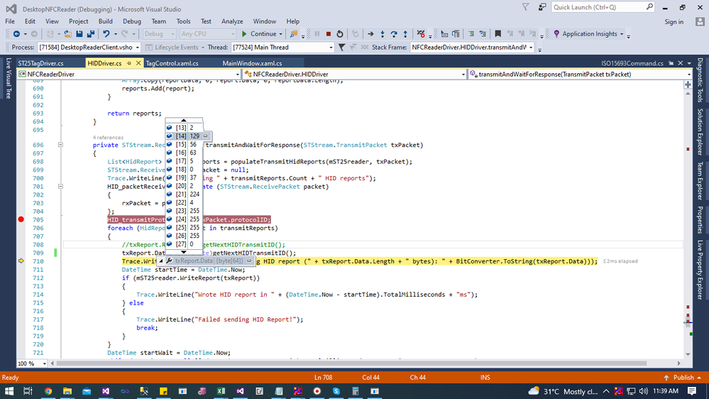

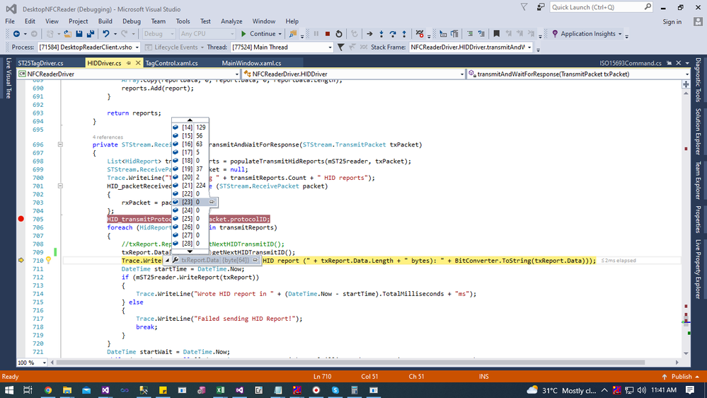

So i looked at the ST25DV datasheet for RF commands and frame formats also the logs of the PC software to understand how the data frame is transmiited and receieved and its quiet easy to understancd.
But as i told previously we already have a half built application made in C#. So i cant move to any other language. In my application currently i am able to perform the inventory discovery succesffuly read the ID of NFC tag. Also i am able to read the data from mailbox (tested by writing data from ST software in Mailbox and reading from C# based software). But when i try to perform the write to mailbox operation it gives me error of invalid command.
There are certain files in my project which add the protocol header to the data frame, which makes my data frame completely different from the one defined in ST25DV datasheet as well as different from the one sent using ST25 PC software. I guess the ST25R3911B_SENDRECEIVE function does the same like adding the protocol headers and other information to the data frame but cannnot verify.
Here is the frame format that's sent for read operation (most of the things i am unable to decode) but is working:
READ:
0F-15-00-44-00-10-04-40-DE-00-0C-22-AC-02-81-38-3F-05-00-25-02-E0-00-00-00-00-00-00-00-00-00-00-00-00-00-00-00-00-00-00-00-00-00-00-00-00-00-00-00-00-00-00-00-00-00-00-00-00-00-00-00-00-00-00
1st byte is counter
AC - read cmdHere is the frame format that's sent for write operation (most of the things i am unable to decode) which is not working and throwing error of invalid cmd:
WRITE :
01-18-00-44-00-13-04-40-DE-00-0C-22-AA-02-81-38-3F-05-00-25-02-E0-04-FF-FF-FF-FF-00-00-00-00-00-00-00-00-00-00-00-00-00-00-00-00-00-00-00-00-00-00-00-00-00-00-00-00-00-00-00-00-00-00-00-00-00
1st byte is counter
AA - write cmd
04 - data length
FF-FF-FF-FF - dataNOTES:
In both write and read packets, (4-5)bytes before CMD code is same (i.e "40-DE-00-0C-22") and bytes after CMD code is same (i.e "02-81-38-3F-05-00-25-02-E0")
So can you please let me know what could be the possible reason why i am getting this invalid command error, although my command is right.
