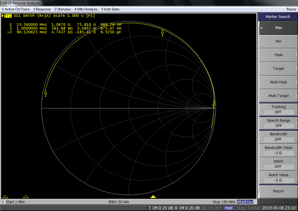

The measured smith chart should look like this:
The necessary data can be taken from Marker 2 and Marker 3.
This measurement can be done using a "miniVNA PRO".
It is also sufficient for antenna matching and fine tuning.
