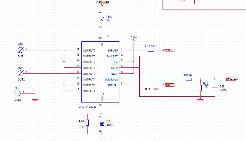

Thank you for your reply.
Please see the attached schematic.
I'm using a schottky SS14. R18 is not mounted because my load is purely resistive.
In the next release I will pull FaultRST and SELn to GND through a 10k resistor. Then I will add a filtering capacitor on the V_power.
At the moment I have solved the problem inserting a diode against inversion also in the positive supply side.
Before that I had many
VND7140AJ damaged.
Best Regards
Mauro Chiara
2017-07-04 6:30 AM
Hi Mauro,
I'm sorry but, in the schematic you posted, I cannot see what is the path leading to have only 20Ohm between Vcc and GND.
Resistor between PWR GND and Device GND is 4.7K, Multisense resistor is about 1K and all the prot. Resistors are ~10K.
When you apply the reverse battery, what is your load?
Please, give me further details
Regards
FG

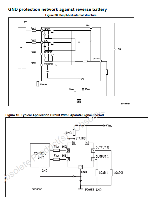

2017-07-05 2:13 AM
Good Morning,
I've found what was the reason why VND7140AJ broke down and presented
a 20ohm path between VCC and GND pin of the chip!!
Without the input Rprot (10K) the chip is not protected by inversion just because in this new family of HSD you suggest to take the MCU reference GND before the diode (on the Cathode).
We are used to the old version in which you suggest
to take the MCU reference GND next to the protection diode (on the Anode).
You should underline that Rprot is ESSENTIAL against power supply inversion protection for the protection circuit you suggest!
Best Regards,
Mauro Chiara
