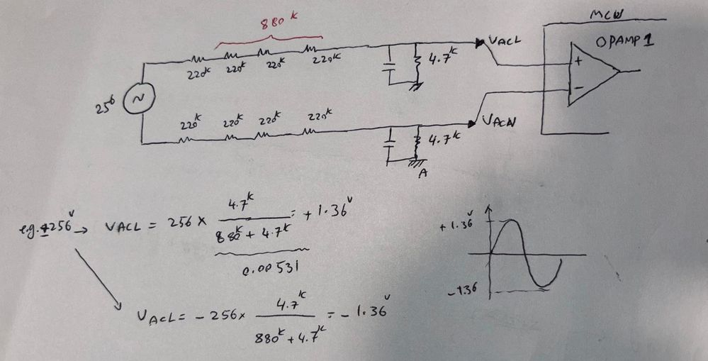

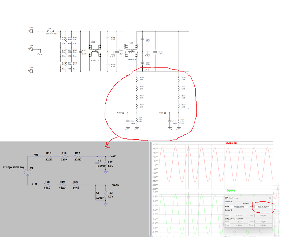

I'm reviewing the Vac sense circuit of STEVAL-7BIDIRCB, where the circuit uses a resistor divider to generate a low voltage of VACN and VACL for MCU. I simulated this section of circuit in LTspice, and here is my result :
My Vac input is +/-256V sine waveform and VACL that I'm measuring is +/-900mV sine waveform.
Based on my calculation this is a simple voltage divider and I should see +/-1.8V sine waveform.
Why am I seeing 1.8V/2 = 900mV ? I did some research and my understating is that when there is an equal resistor network each side of AC source ( N and L), Vac IN becomes half ( 256V -> 128), but I don't understand how it is possible when my Vac input is 256V ?

The VAC sensing network on the STEVAL-7BIDIRCB is not equivalent to a simple single voltage divider. Each sensing branch uses the full series chain of four 220k resistors (e.g. R149, R153, R157, R159), not just three, are connected to the two AC conductors L and N forming together a differential measurement of the mains voltage. If you only use three 220k resistors as in your calculation, the divider ratio is overestimated and the expected output becomes too high.
With the correct resistor chain, the voltage at VACL/VACN is reduced accordingly, so a measured sine amplitude of around ±0.9V is consistent with the schematic. In other words, the lower amplitude is due to the complete symmetric sensing topology, not an issue with the circuit.
Please also note that Protective Earth (terminal H between L, N) is not connected to GND (marked with A)!

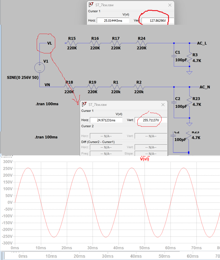

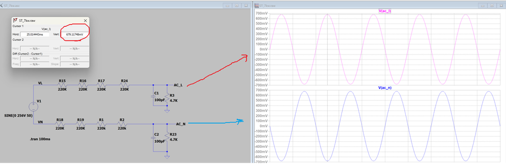

Thank you very much for reviewing my post and sharing the information. I have updated my simulation: I am now using four 220kΩ resistors in series and a 4.7 kΩ pull-down resistor to ground. Here is my new result: each side (N and L) shows a sine waveform of approximately ±670 mV, with a 180 phase difference.
However, based on my calculations, I expected to see ±1.36 V instead of ±670 mV.
Q1: Can you please advise why there is this discrepancy? Am I missing something?

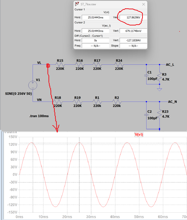

Q2: why am I measuring approximately 128 VAC (half of 256 V) when I measure VL with respect to ground? However, when I disconnect VL from the circuit, it shows to 256 V.
Q3: Can you please help me understand how a symmetric sensing topology reduces the voltage from 256V to128V? Which voltage should be considered when calculating the resistor values?

So, if you now use four 220k resistors per branch, the smaller amplitude you measure at VACL / VACN is consistent with the schematic. The value of about ±670mV is therefore not unexpected.
For Q2 and Q3, the apparent 128Vac with respect to ground is also a consequence of the symmetric arrangement. Once the full network is connected, the line voltage is no longer observed as an isolated source-to-ground signal, but as part of the complete divider structure between VL and VN
