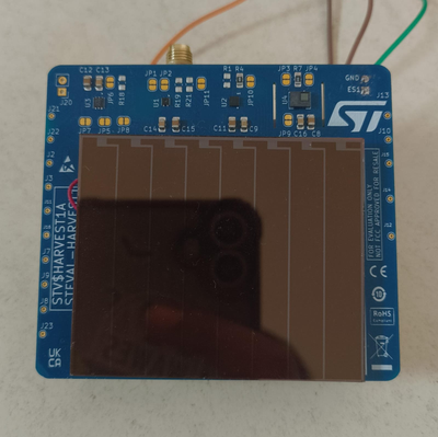

Are there any more resources to understand how to use STEVAL-HARVEST1, how does the energy flow from super capacitors to the MCU and also the back up capacitors. I feel few things are missing the schematic and the user guide. I want to first implement a small UART program with energy harvesting. Can anyone guide through steps in achieving it.image.png
How to connect this to board, does it mean I need to add any external wire from harvester solar panel and short it here?

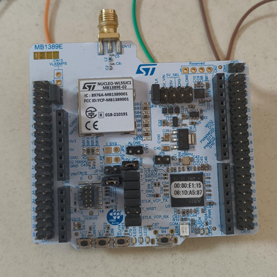

Thank you for the response. I reviewed the materials you pointed to and wrote a small test program to toggle a GPIO in order to observe the harvesting behavior. However, I still do not fully understand how the system is intended to be configured in harvesting mode.

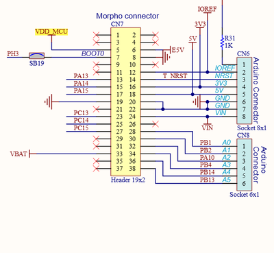

From the referenced image, my interpretation is that the positive terminal of the energy harvester should be connected to VDD_MCU. What is not clear to me is what exactly is meant by the “positive terminal” in this context.
After examining the schematics of both the harvester board and the WL55 Nucleo board, I assumed that, in order to charge the tantalum capacitors (C2, C4) on the harvester, the solar panel output should be routed to the E5V pin. My understanding is that the ~5V from the solar panel is then regulated down to 3.3V by the onboard LDO, supplying both the MCU and the storage capacitors when the harvester is connected.
To implement this, I connected C7 pin 2 to pin 6, effectively routing the solar panel output to the E5V rail.
With this setup, I observed that the voltage across the harvester capacitors (C2, C4) does increase, but very slowly. The maximum voltage I observed was around 2V, after which it quickly drops to approximately 1.7V.
My questions are:
  1. Is connecting (or effectively shorting) the solar panel output to the E5V pin the correct approach, given that this step is not explicitly described in the documentation?
  2. If this approach is correct, what kind of charging time should I expect before the system can reliably execute a simple task like a blinking LED?
  3. If this approach is not correct, what is the proper method to charge the capacitors C2 and C4?
  4. I understand that the supercapacitor C1 is charged via a GPIO, but I am unclear on how the stored energy from C1 is then used to power the system.
Any clarification on the intended power flow and correct hardware setup would be very helpful.

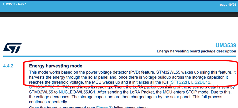

In energy harvesting mode, the solar cell charges the storage capacitors on STEVAL-HARVEST1 through the board’s harvesting path, and the MCU is then powered from the stored energy when the voltage reaches the PVD threshold. The “positive terminal” simply means the positive supply node of the harvested energy path, not the raw solar panel output routed to E5V.

These are the connections that I have made

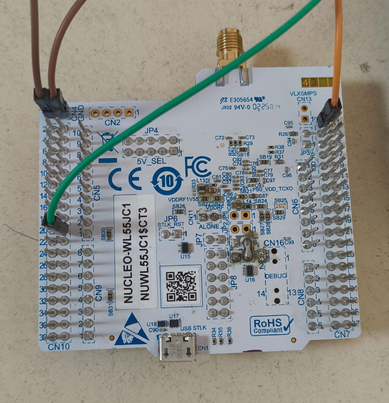

SaiVenkat_0-1777270998184.pngSaiVenkat_1-1777271037415.pngSaiVenkat_3-1777271465330.png
One thing I never understood is how does the power flows from the solar panel to the nucleo as VPV pin is connected to nothing. Do I need to short it to anything like VPV and VDD needed to connected or something. I think it should not be done as according to the datasheet max the pin can take is only 3.6V
And my other doubt is according to figure 11 from um3539, does JP9 and JP1 needed to be shorted? I think both are already shorted on the board, as per my understanding there is nothing to do with figure 11 correct me if I am wrong.
Thanks in advance

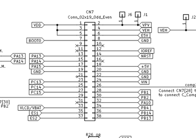

I’m trying to understand how the C2 and C3 is actually being charged on the STEVAL-HARVEST1 energy harvesting board.
From the schematic, VPV (harvester input) doesn’t seem to have a clear path to VDD. Because of that, I’m not able to see how power is supposed to reach the MCU under normal operation.
While debugging, I probed near the VDD pin and observed that the voltage only rises when I manually short VPV to VDD. This makes it look like there’s no active or defined power path between VPV and the MCU supply.
Based on my understanding:
  • C2 and C3 should be charged from VPV
  • Once they reach a certain threshold, the MCU should power up
  • PVD should then handle wake-up behavior
However, I’m not able to identify:
  1. A clear charging path from VPV to C2/C3
  2. A controlled path from those capacitors to VDD
So currently, it’s unclear how energy flows from VPV → storage → MCU without externally shorting nodes.
Am I missing a power management stage or switching mechanism in this design?
Thanks in advance.
