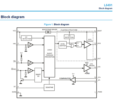

so for the driver to run : whats on its error pin , OD/SD ?
2025-09-09 4:24 AM - edited 2025-09-09 4:25 AM
Thanks for your response. I checked the OD/SD pin as you suggested — it is not low, I measure some voltage there.
The issue is that although I am driving the input pins (LS_IN_PWM, HS_IN_PWM), the outputs to the MOSFETs (GATE_HS, SOURCE_HS, LS) are not switching. The MOSFETs themselves are fine (I checked them with a multimeter).
So I am not sure if the problem is:
Configuration of the driver IC (maybe I missed a requirement for enabling it), or
A protection/fault condition that is preventing the outputs from switching.
Thanks for your support.
2025-09-09 5:40 AM
As this OD/SD pin is crucical for run or error/stop , exact voltage and check with a scope: constant and clean , or... ?
As OD/SD pin is the only enable-or-error deciding pin.... check it !
