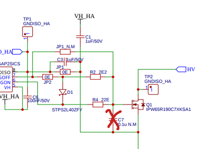

We have developed a three‑phase servo motor drive using STGAP2SICS isolated gate drivers and IPW65R190C7XKSA1 MOSFETs.
The inverter works perfectly at low DC input voltage (25–40 V DC).
However, when we apply 230 V AC (rectified ~320 V DC) and send control signals to the U, V, W inputs, MOSFETs Q1, Q2, Q9, and Q10 fail immediately, even under no‑load condition.

>STGAP2SICS gate driver configuration
1. I hope you have no 0,1u there ! NO cap here.
2. gate resistors: i would start with value from ds : 10 + 10 ohm
3. remove D1 . (what should it do useful ?? )

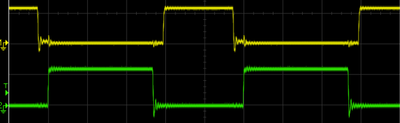

4. with new mosfet ... :) , no HV power supply + load : check with dual channel scope the gate signals !
looks like this:
(for this test connect scope probes + ground to hi+lo gate + source ; without any supply on HV !!!)
IF they look fine, remove probes, try with HV (30V or so) ; if good , = almost zero supply current , apply some load.
IF all fine, try with full HV .
