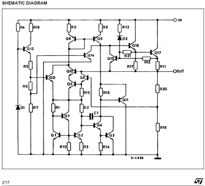

1. I assume that Q14 controls the thermal protection,but Is it correct that, when certain conditions are met, the regulator IC output voltage may be fixed at 3 V?

We are facing a phenomenon where the output voltage of the L78M05AB regulator IC used in our application latch to 3V.I am asking this question to help identify the cause.
1. If the resistance value of R11 changes, how will the output voltage of the regulator IC be affected?
2. What could cause the output voltage of the regulator IC to drop from 5V to 3V?

  1. Which event is supposed to change the value of the fixed internal R11?
  2. We have reached a point where you should please show the schematics of the immediate surroundings of the L78M05 (or better the whole schematics of the power supply) so that a proper answer can be given.
