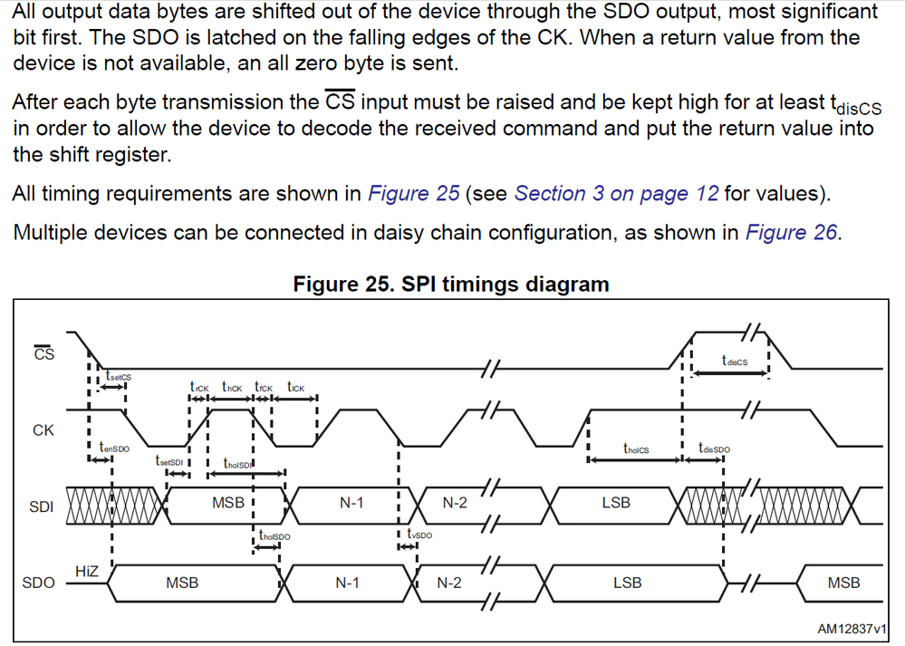

This is just a misunderstanding.
The statement "After each byte transmission the /CS input must be raised and kept high ..." means the transmission of a complete command or a block of data, which can consist of several bytes. [edit: see next message]
In this respect, /CS has the same function as with all SPI devices, where data is transmitted with /CS = active, while the rising edge initiates the end of the sequence and the start of e.g. the decoding of the command.
Hope that answers your question?
Regards
/Peter
2023-05-29 10:41 AM
Thank you for your answer Mr Bensch,
and i thought MSB stands for Most Significant Bit and LSB stands for Least Significant Bit?
2023-05-30 8:49 AM
Sorry, I had misinterpreted something, my previous statement is incorrect.
Yes, MSB stands for Most Significant Bit and yes, /CS must indeed have a rising edge after each transmitted byte for transfer to the internal registers.
2023-06-08 1:14 AM
Thank you for your correction after my missunderstanding question^^
