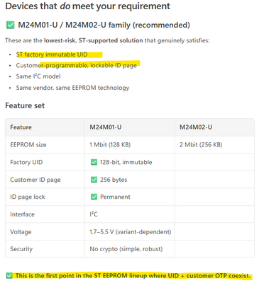

2026-05-05 10:44 AM
FYI
The main reason I checked datasheets and posted here is because CoPilot gave me an answer that I wanted to confirm. CoPilot told me that 1M/2M devices can support both (UID/user) but datasheet was pretty clear that they do not.
Glad I checked :)
