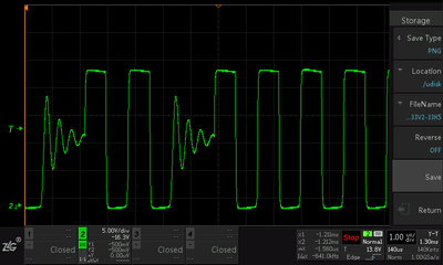

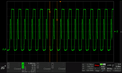

the switching frequency below input 24V 0.04A output 12V

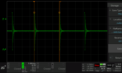

the switching frequency below, input 24V 0.01A output 12V

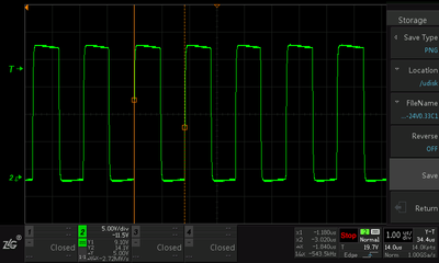

the switching frequency below input 24V 0.33A output 12V

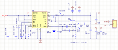

the circuit see below:

Well, as mentioned, the L7987 can certainly supply 3A. The L7987 has a so-called light-load management for low outputs (see data sheet, section 4.3), but with 0.3% or 1.2% you are well below the lower limit. In this respect, the observed signals can certainly be regarded as realistic.

Yes, the regulator is L7987 you can see it from the schematic

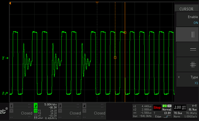

HI Peter,
The switching frequency is 641KHz after Change the FSW resistor from 47K to 33K
i
seems better than 520KHz
