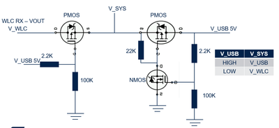

Also you can refer to this
Solved: Using a STWLC38 with an optional USB-C charging - STMicroelectronics Community

I was confused because the datasheet says that it operates in SA mode when 5V is applied to the VOUT pin. Thank you.
