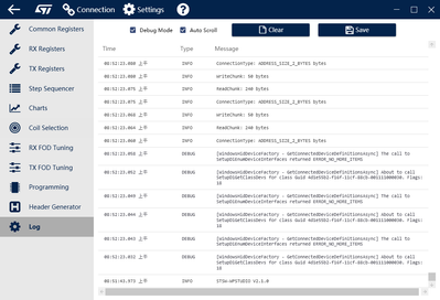

about GUI connect issues, i suggest you use
https://github.com/STwirelesscharger/STSW-WPSTUDIO/blob/main/STSW-WPSTUDIO%20V2.1.0.exe
a1_wlc38_downfw.bat to download fw automatic.
Also please check GUI log and post it if still fail.
