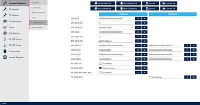

What I want to do is simply send a byte, like "0xAA", from RX to TX. So I have set the WPSTUDIO like in the following image.
At first I've pressed the "W" button to MSG SEND1 with the field filled with "AA", then I've pressed the "W" button to RX SEND MSG/Perform action.
Nothing happened on TX side. The TX PP PKT RCVD LTCH is still to "Did not occur" and the 0x100 address is empty.
There is something wrong on what I have set on the Communication tab?
Thank you all.

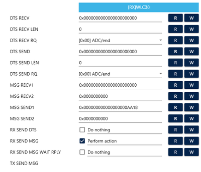

Hi Filippo,
As you want to send a proprietary message, you must add a PP header so that it is recognized by the Tx.
For "AA" sending, you must write AA 18 in the register (0x18 is the header defined by the Qi standard to send 1 byte):
If you want to send "AA BB", you should write AA BB 28 in the register, and so on.
Regards.
2024-06-24 7:47 AM
Hi Didier,
Thank you for the quick response.
I have followed your hint and now I have been able to send PP from RX to TX. Thank you again.
