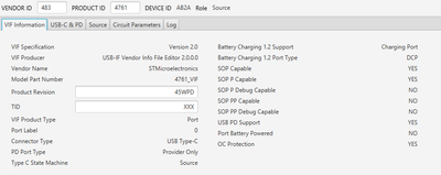

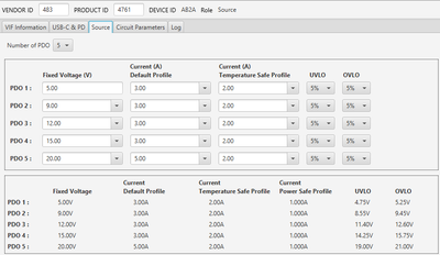

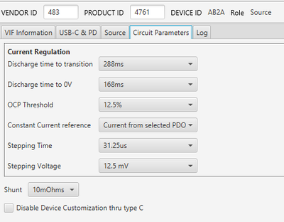

2024-11-27 8:02 AM
Hello
There are multiple things that I don't understand.
Snapshot shows 'powered' for VCONN, which means that stusb4761 will supply vconn and check for the cable (i.e cable is not captive). If cable is 5A, capabilities will be 5A max, otherwise, they will be clamped to 3A.
In trace you share, source-cap @20V is 5A but there is no cable messages (SOP').
To reproduce such trace I need to turn Vconn to 'grounded', which is supposed to be used when cable is captive.
Then, when sink request 5A, it is accepted, I do not observe reject message.
1/ can you please confirm that after flashing the device, DUT is powered cycled ?
2/ Can you please shared NVM content using 'export NVM file' button ?
3/ may I know which sink is used ?
Best regards
Nathalie
2024-11-27 10:50 PM
Hello Nathalie
Thank you for your reply.
Our PD source will have a standard USB-C receptacle and is to be used with a standard, 5A rated and e-marked USB-C to USB-C cable, no captive cable will be involved.
To your questions:
1) Yes, I can confirm the power cycle
2) see the attachments (read out this morning)
3) We use Acroname "USBHub3c Pro" as sink for our tests. I'm already in contact with them because of the missing cable messages (SOP') in the trace.
Additionally, I'm going to do the tests with other sinks, for example the STUSB4500 evalboard.
Do you know other suitable equipment to test USB PD sources?
Best regards, Michael
