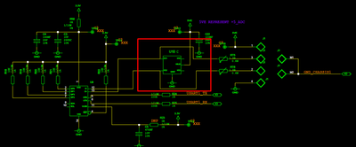

We are using USBLC6-4SC6 TVS Diode in our design for USB line. The schematic is shown below:
We have connected IO1 pin in parallel to D+ line and IO2 pin in parallel to D- line of USB data lines where as IO3 and IO4 lines are left open.
Can you please let me know is the connection is correct? Let me know is any modification is required for USBLC6-4SC6 connection.
