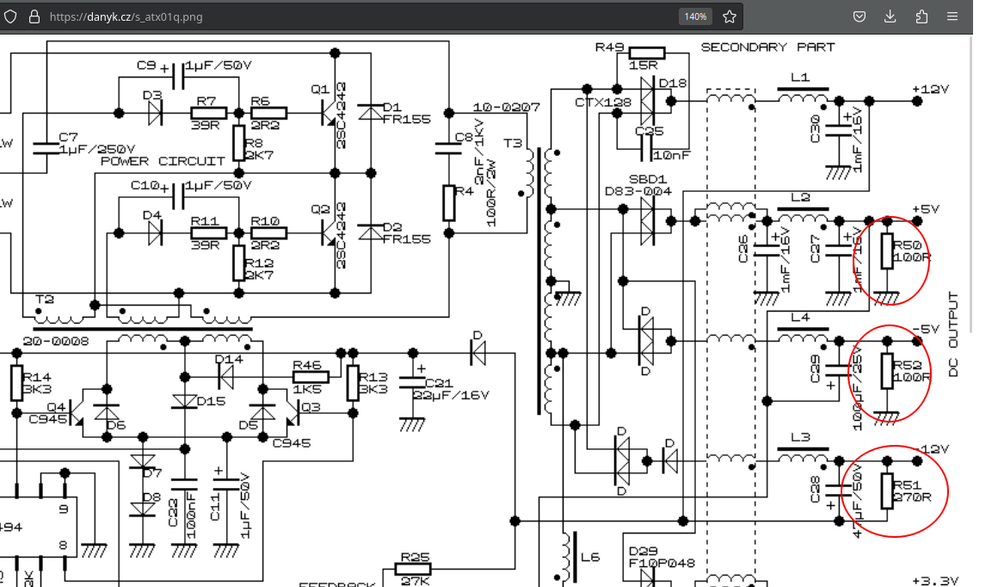

when there is no load, I hear this clicking noise and the output of the LM5116 is much more variable
Computer ATX power supplies usually have a load resistor.
2023-08-17 12:44 PM
Interesting.
So they constantly have something to draw a little bit of current just to satisfy the needs of the converter? I was not aware of that! (Still green to the field haha).
Thank you for this!!
