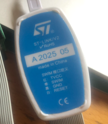

2026-02-09 7:12 AM
2026-02-09 7:34 AM
That one looks counterfeit as well, unless the markings have changed.
How to recognize a genuine ST-LINK/V2 versus a clo... - STMicroelectronics Community
Plus the board is likely counterfeit.

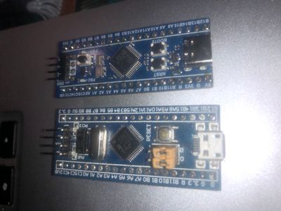

2026-02-09 8:41 AM
@chriskuku Note that you can put the image directly in the post - then we can see it:
That's a fake - see this post by @mƎALLEm
You still haven't said what board you're using
2026-02-09 1:32 PM
Either of these - the newer one is a WeAct Studio
2026-02-09 2:00 PM
In the end it turned out that the bluepill I was using was faulty. Dropped in another one and things vanished into thin air.
