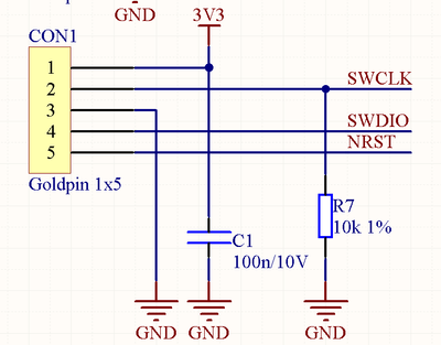

I am developing the Prototype with STM32WL microcontroller to which I provide a schematic snippet below:
+ SWD 1x5 goldpin connector:
If the image quality doesn't let you inspect the nets, I will provide a better image later.
The 3V3 voltage is stable, SMPS delivers beautiful 1,55V and I was able to connect to the uC and program it with ST-Link V2.

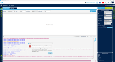

Here's my problem: when I tried to program my Prototype with Nucleo's ST-Link (N-ST-Link) I was unable to connect to device. N-ST-Link has SW version of V2J46M32 and I use STM32CubeProgrammer Version 2.20.0 I connected VDD, GND, SWCLK, SWDIO and NRST signals between boards, clicked "Connect" and received following message:
During debugging I checked the voltage of NRST pin. When N-ST-Link's NRST pin is disconnected the Prototype's NRST voltage is equal to 3.3V. When I connect both NRSTs signals, the voltage drops to 1,55V. When Prototype's NRST pin voltage drops for the first time the uC is still running (debugging diode is blinking), but when I hit "Connect" I receive the error message shown above and uC's program halts.

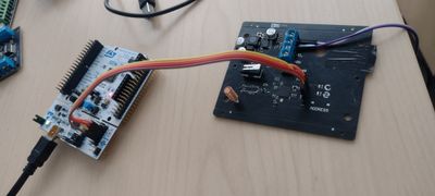

@Andrew Neil Here I provide the photo of a setup:
The "VDD_Target" pin is disconnected as it was proven in this thread that Nucleo supplies its own supply to "VDD_TARGET". The ST-Link V2 is hidden as it is not a subject to the problem.

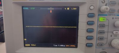

@TDK If I were exceeding regulator ratings there would be a lot of heat coming from at least one of the ICs on N-ST-Link or my Prototype, wouldn't it? All is cool, PC still detects Nucleo as USB device and my board draws stable current of 5 mA (mind the other PCB circuitry) and regulators produce stable voltages. I haven't checked whether STM32WL is resetting itself, I have to prepare a code for that, but regular blinking of a 1s diode timer somehow tells me that the uC is not resetting itself. There are no voltage fluctuations on NRST pin as well. In order to suppport my claim I provide an oscillogram of NRST:
I switched between 1 us/div to 50 ms/div and it all looked the same as pictured above.
Is there a chance that I have damaged two units of N-ST-Links and what we see is the cause of mentioned damage?

I see no ground link between the two boards?
Your Rigol scope should have a USB socket for getting screenshots - that will give far better results that photos!

2025-09-18 1:54 AM
@Andrew Neil The yellow wire connects GND of N-ST-Link and GND on my Prototype.
I wanted to get the image as soon as possible, that's why I used my camera. Next time I will use USB drive.
