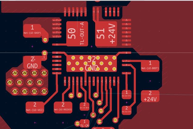

Yes it does thank you.  Another question...pins 1-4 are no connect.  Would it be ok to connect these to Vm?  It allows for a wider trace connection to EPAD2.STSPIN9P12-vm-pins.jpg
Yes, you can of course connect the nc pins 1...4 freely, as can be seen, for example, in the GERBER of the evaluation boards.
Regards
