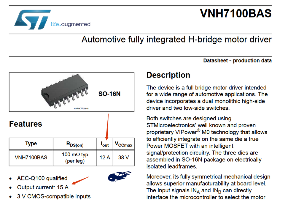

2026-02-26 12:48 AM
So how about 12A and 15A mean in the VNH7100BAS datasheet?
2026-02-26 1:56 AM
