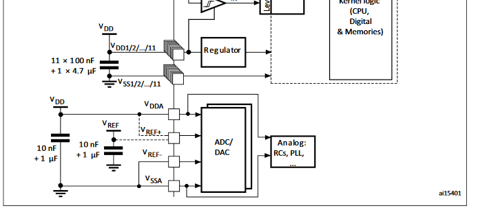

I m designing a board with a STM32F103. I was wondering about capacitors value. In STM32 documentation, it's written to use 100nf per VDD PIN + one 4.7uF.
On the other side, I m using a low dropout regulator :
I dont' understand where to place the 4.7uF capacitor...
If you could help me, I will be thankful :)
Regards,
