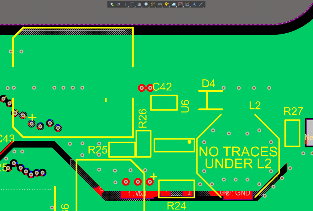

I'm thinking this problem could be coming from a "bad layout". My question is: What pins of which parts need to be located physically close together to minimize the switching current loop for the MC34063's inverting DC-DC Converter using the datasheets recommended application schematic.

I cant see the inner grounds to well on the views, but do see the "seperation" of the top/red layer grounds between the Inductor and C43 ground. as an experiment, try a slice of copper tape soldered in a fashion over the top of the ic, to connect the grounds together. it seems you have enough vias in some places , but i have seen a lack of just one via for an TI parts IC ground to cause it to get squirrely. worked fine on prev rev, then the via got dropped of the pcb on the next rev....sooo back to the pcb shop LOL!
another experiment maybe take a short piece of wire, solder to connect the top grounds together in the spot where the silkscreen marking is for L2 and r27 ~ area

My second layer (this is a 6 layer board) is a solid ground underneath of this circuit. The slice in this screen shot is because I physically separate the amplifier and ADC circuit that is next to this regulator. Connecting a ground on top of the circuitry shouldn't help (except for covering the inductor with a shield).

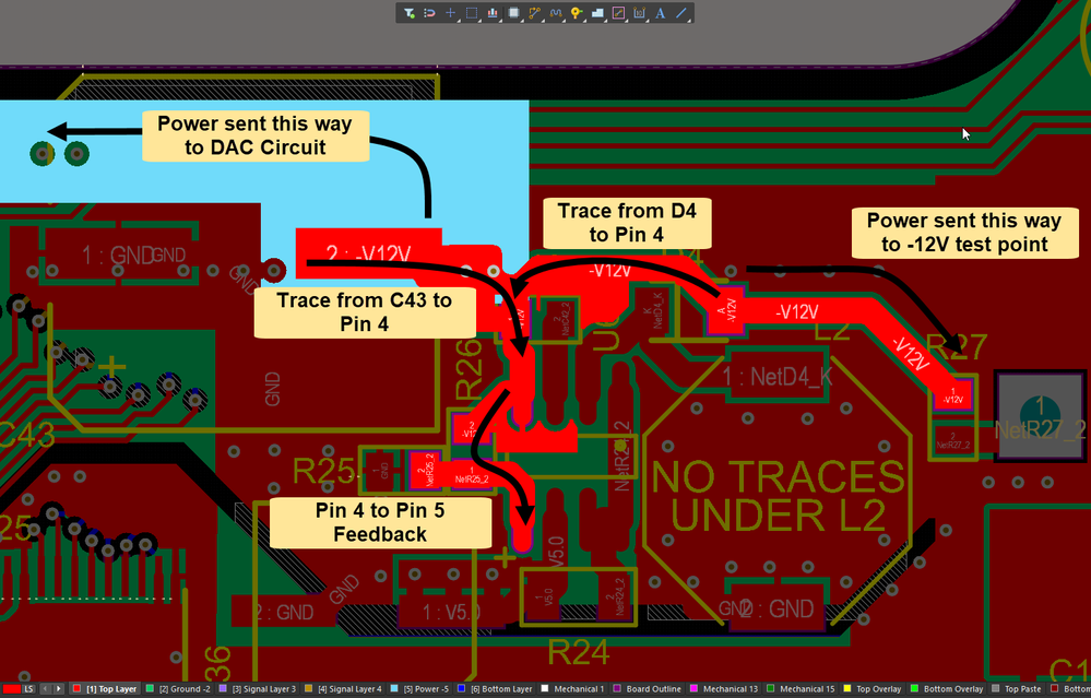

And I believe my pins 2/4/5 have very short traces, but maybe D4 could be closer to pin 4??? What do you think?
Here is how it is laid out:

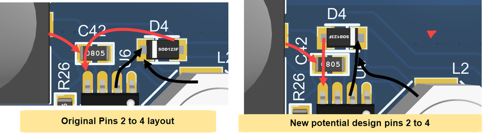

Perhaps I could flip the diode over and get it closer to pin 4. What do you think about this? Could it solve the problem?
