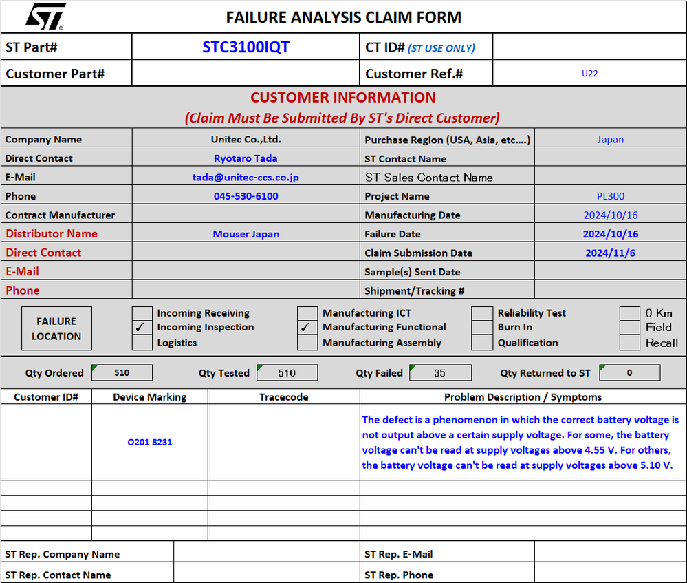

Hi Benedikt-san,
Thank you for  your replay. it is good helpful information for me.
I would like to share our status for you.
We have screened individual ICs and found that some of them behave strangely at 4.5-5.5V.
Please see as attached file
Would this be relevant to the information you mentioned?
If you have any information or comments, let me know.
Best Regards,
Yoshi
