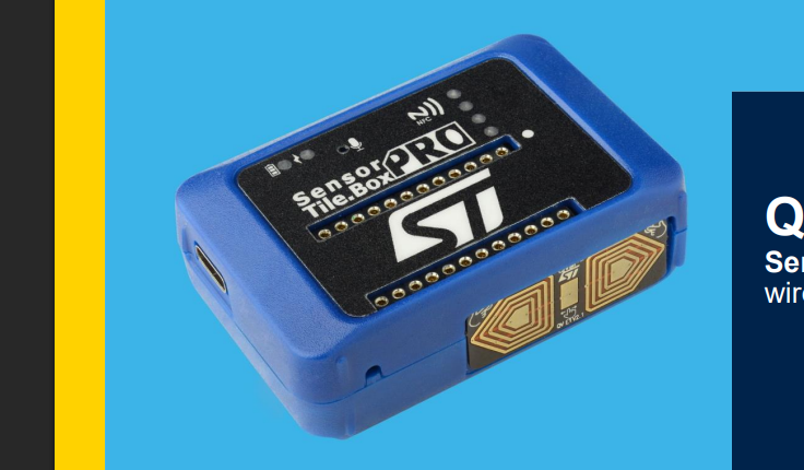

So starting analysis, the X axis now representing gravity vector in the table, I knew I had the box sitting on its side in a slot in the column, so if I am looking at the box, I was wondering what axis system matched the box and the unit.

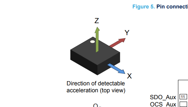

Your data sheet shows
The whit dot is important

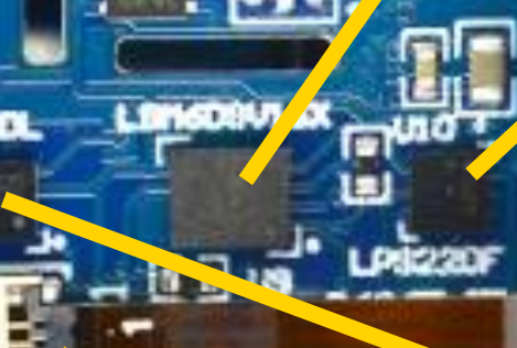

I think the white dot is in the bottom right hand corner, is the white dot on the board an indicator

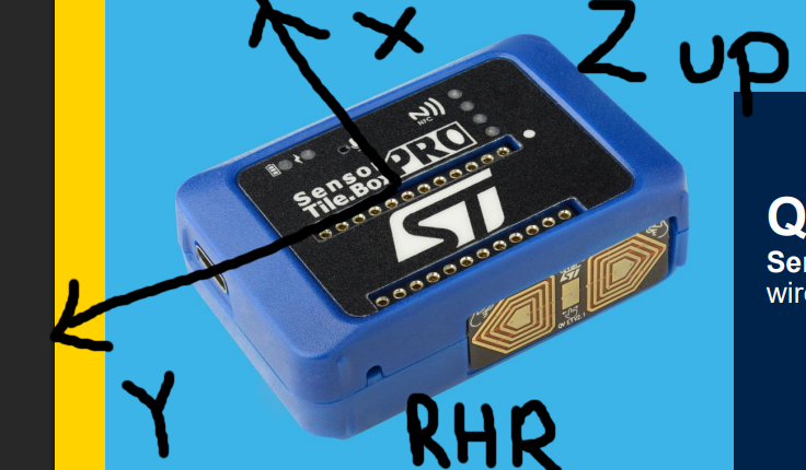

so X is parallel to the short axis of the box laying down, the Y axis is parallel to the long axis lying down and the Z axis is vertical.   Please confirm, as I have no desire to take the box apart.

I would suggest that a normal human would assume Y parallel to the device short axis as matches most math textbooks.
