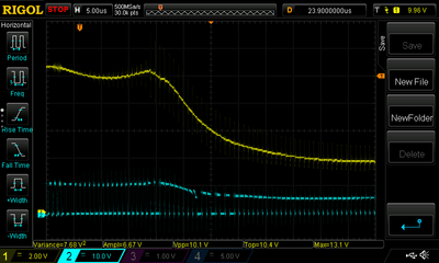

LX voltage looks very strange even when unloaded, there is a spike during the low cycle:
When the IC is warmed up, the spike goes away and the graph looks clean.

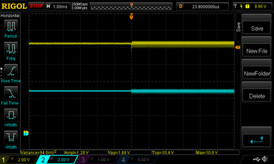

Here are some scope shots showing the drop:
[Blue = INH]
[Blue = LX]
Here's how it looks on a 'good' board:
[Blue = INH]
I would appreciate any feedback/advice/speculation.
