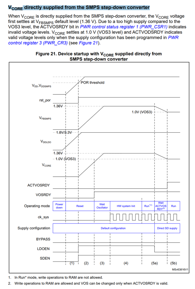

looking in the RM (Figure 21 , page 239) I see this figure
Specifically it says at the bottom
"1. In Run* mode, write operations to RAM are not allowed."
This statement does not clarify what RAM it refers to. SRAM, ITCM, DTCM, AXI RAM, All of the above?

From the power up sequence
As long as ACTVOSRDY indicates that voltage levels are invalid, the system is in Run* mode, write accesses to the RAMs are not permitted and VOS must not be changed.
