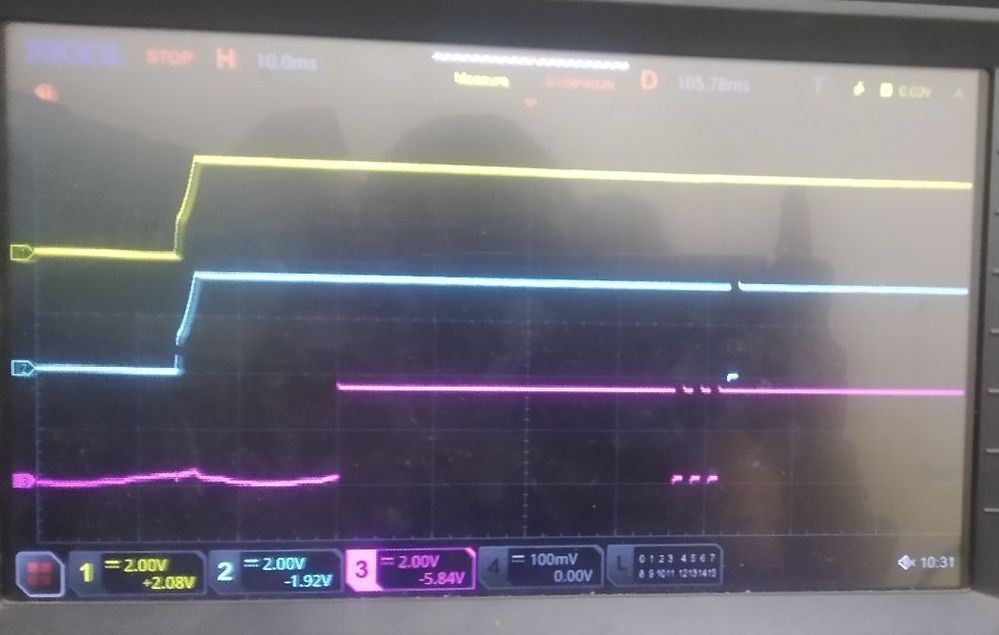

We are using STPM32 with LPC controller, when observing the startup reset pulse we are getting as in the picture attached. Both SYN and SCS pins are initialized high but when powered on SYN is coming low for some time then it is taking 35ms delay then 3 pulses similar is the case with SCS. It is coming high for some time then it is taking the delay we are setting and data is also not getting updated.Startup reset pulse Can anyone tell whether the startup reset pulses we are getting are correct. And help resolve the issue?
Thank you
