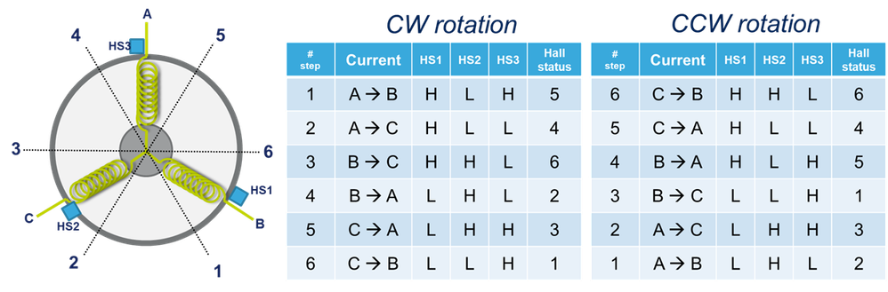

Considering your table, one can observe that it corresponds with the firmware table with the following match:
and
Doing so, the first configuration of the table (HS1 =1) would be H3=1 -> case 1 of reference < 0 -> W active and switching (CCR3=pulse_value and CCER= TIM_CCER_CC3E | TIM_CCER_CC3NE) and V active (CCR2=0 and CCER= TIM_CCER_CC2E | TIM_CCER_CC2NE) that corresponds to your table CH=1 and AL=1.
In conclusion, if the table is specified for counterclockwise direction, with the motor connected as above, the firmware should properly work.
If it doesn’t you just need to replace the condition Reference > 0 with Reference < 0.

I double-checked firmware and provided decoding table.
Considering that the commutation table refers to CCW rotation, that is the one implemented in the firmware, corresponding to the standard motor configuration in the picture where A, B and C are U, V and W phases respectively.
So, if connections are OK, nothing should be changed.
Otherwise, in case the commutation is supposed to be in the opposite direction, you only need to replace if(Reference > 0) with if(Reference < 0).

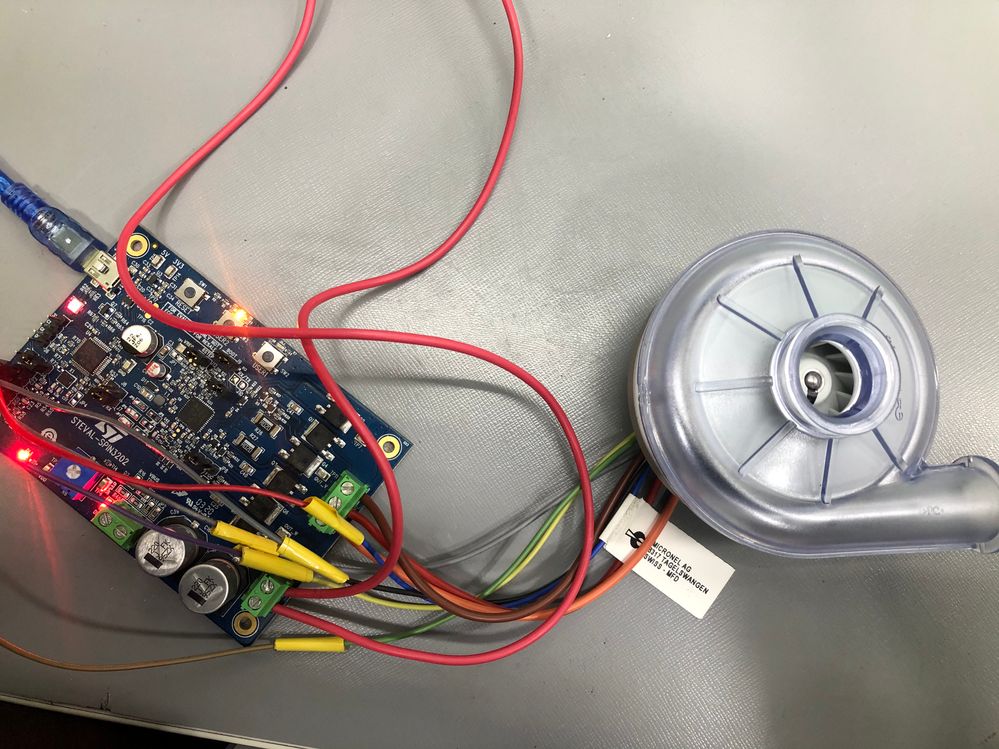

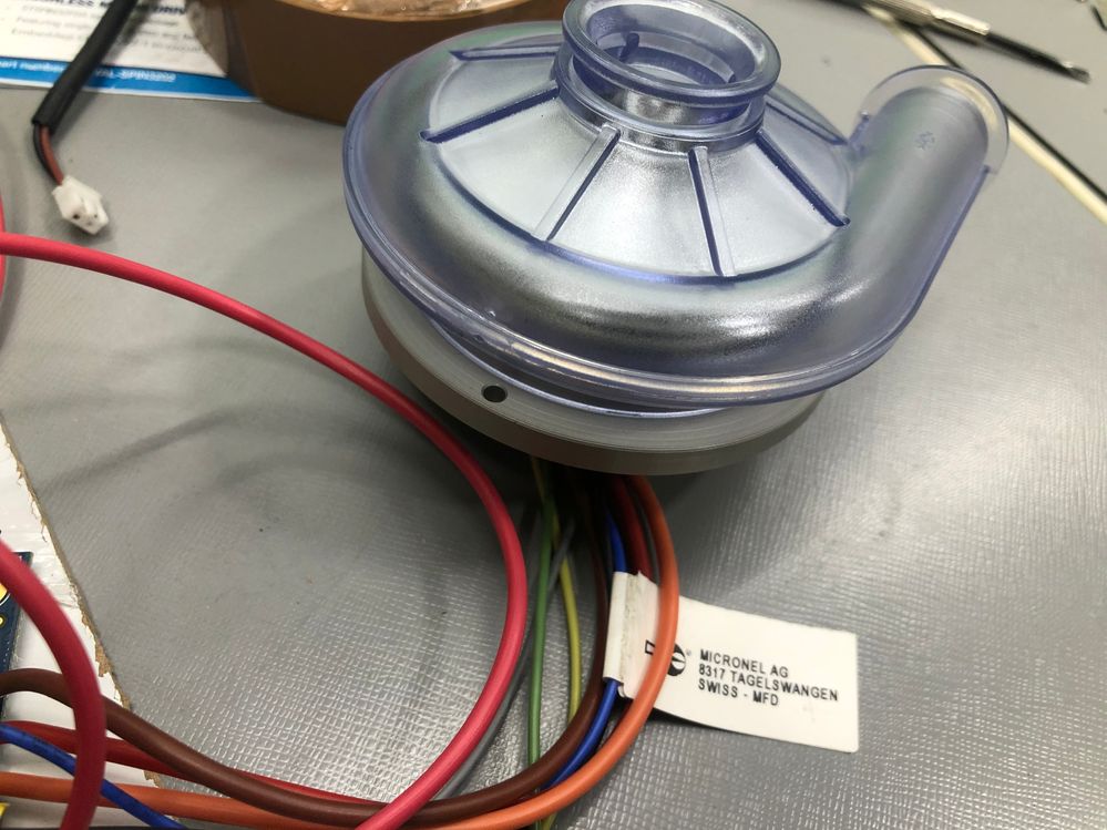

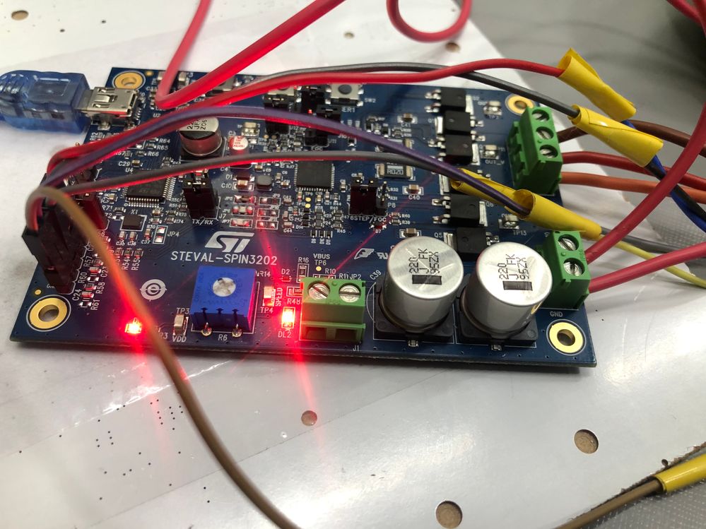

Hi @Cristiana SCARAMEL . I have attached some of the photos of the eval board and motor connections, please do check it . As far as I know , the connections are good , the only problem I am facing is in firmware, because your previous solution i.e"Changing of case x:", helped me to atleast run the motor with some lag in startup state but at run state it gives an error and stops the motor to run. Please see through my queries and provide me the solution. Thank You.
2021-03-23 10:27 AM
Hi @SJosh.6,
your hardware connections look ok.
The previous change of the “case x�? wasn’t right. With Hall sensors the firmware may be able to spin the motor even if not properly driven but inefficiently.
