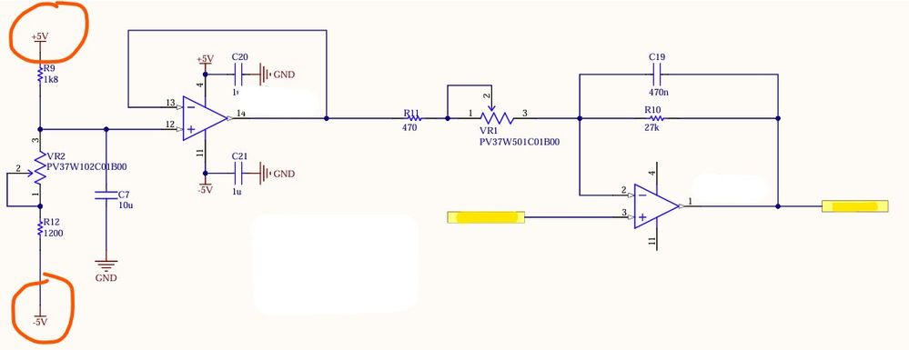

I am looking for two voltage references to produce two rails ( positive and negative) with low frequency noise.
The voltage reference does not need to have a tight output voltage accuracy and long term precision. It needs to be stable over a 1minute period and this is why I am looking for low 1/f noise.
The application is shown in this circuit and I need to get these two references to supply the voltage divider. So far I was supplying the divider with the same +/-5V used for the amplifiers and taken from two linear voltage regulators ( L78L05ACUTR for the +5V L79L05ACUTR for the -5V): with this setup I get too much noise at the output of the second amplifier which can amplify up to a factor x57. This noise is not coming from the opamp ( is a low noise opamp from a competitor OPA4205) or the input at pin3 which has been already proven to be noise-free.
Can you recommend a couple of possible IC to produce two stable references from the +/-5V already present in the circuit? Ideally the ICs should have fixed output at 3 or 4V and be low-cost. The 1/f integrated noise over 0.1Hz-10Hz as low as possible.

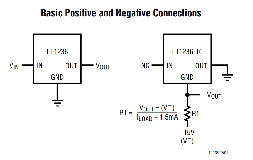

Hi Tommino, you could consider this solution:
https://www.analog.com/media/en/technical-documentation/data-sheets/lt1236.pdf
Of course you should use the LT1236-5 instead.

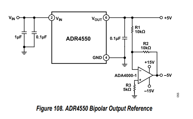

Another option:
https://www.analog.com/media/en/technical-documentation/data-sheets/adr4520_4525_4530_4533_4540_4550.pdf
