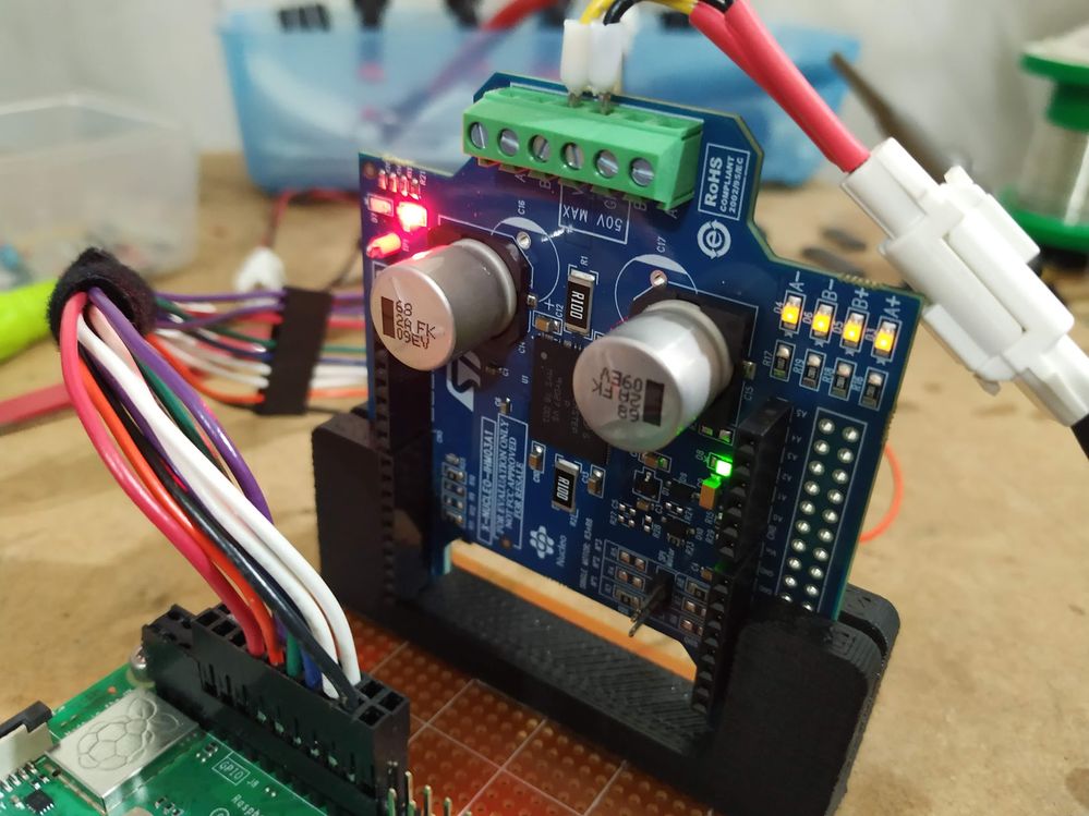

My powerStep01 is constantly triggering the Overcurrent alarm whenever I give a movement command, even if there is no stepper connected. What could possibly be causing this? Previously I was getting a similar effect on the L6470 chip. When I turned off the overcurrent shutdown feature the chip fried and apparently took out GPIO25 of the Raspberry Pi that was command it. In both cases, the motors never moved.

I am using the ST eval board ( the IHM03A1). I'll have to write a function to generate a textual dump of the registers, however, should the driver even experience an overcurrent event even if no motor is connected? Would fluctuations on the power rails (VDD and VS) trigger a false positive?

I'm going to measure those voltages (somehow) and get back to you. Also, should the motor phase lights be on even when there is no motor connected?

The motor phase LEDs are connected to the OUT pins, so they turn on and off if a voltage is applied on them, regardless the motor is connected or not.
In your specific case the bridges are in high impedance, but there are few volts (2.4V) due to leakage current of the OUT pins.
The LEDs turns on, but the light is not so bright as in the case the device is driving the motor and Vs is applied on the OUT pins.
All the voltages you measured are ok, so the eval board seems to work fine.
