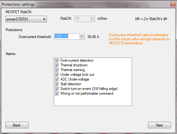

I use SPINFamily tool for ihm03a1 to calc my settings. I try to select Vth, but I can see unreal Ith like 38,46 A. Why?
2020-08-21 8:33 AM
@dungeonlords789 The 38.46A seem reasonable with an over current threshold of 1000mV. How did you arrive at this value?
2020-08-21 2:08 PM
If 1000mV threshold means 38.46A why ST gives me possibility to use this level for 10A powerstep01? 38.46A is unreal for 10A driver, isn't it?
2020-08-23 12:48 AM
It's a theoretical limit based on the Rdson I guess. @Cristiana SCARAMEL
