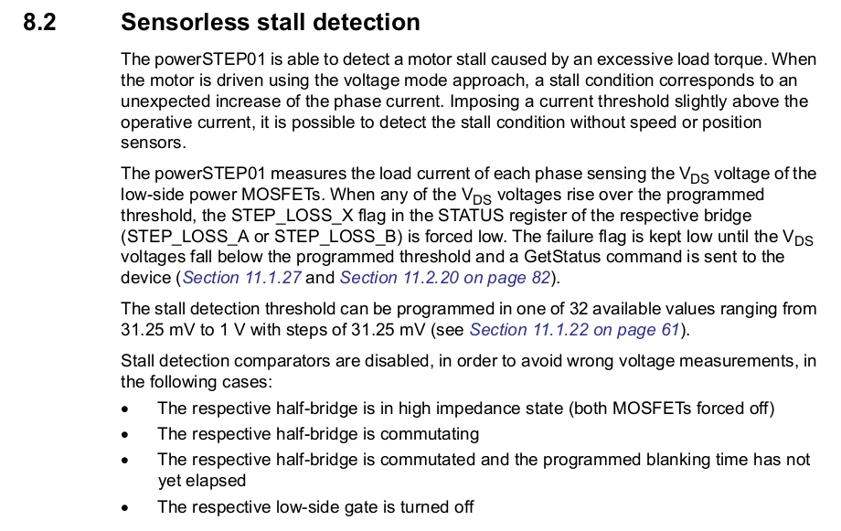

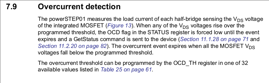

The two functions you mentioned work on the same principle, that is to measure a current threshold through sensing the VDS voltage of the integrated MOSFET. However, as described in the powerSTEP01 datasheet, the purpose of the two functions is different.
The overcurrent detection is a protection against overcurrent events, while the sensorless stall detection is able to detect a motor stall caused by an excessive load torque (when the motor is driven using the voltage mode approach) so an overload condition.
The stall detection threshold can be set to a current level slightly above the operative current. The overcurrent threshold can be set to a higher value sufficient to protect the device according to your operating conditions.
