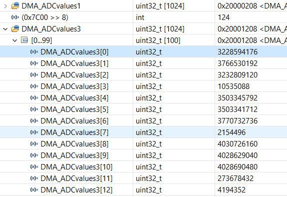

2017-11-25 2:05 PM
ADC values are here, but it is funny how they difference of one measurement to another is quite big - could it be that they are indeed correct or possible, or it is some flaw in my program?
I am using:
hadc3.Init.Resolution = ADC_RESOLUTION_12B;
and
sConfig.SamplingTime = ADC_SAMPLETIME_2CYCLES_5;
Should I use half word, or word in dma alignment?
hdma_adc3.Init.PeriphDataAlignment = DMA_PDATAALIGN_WORD;
2017-11-25 6:04 PM
OK found the mistake... I was using,
hadc1.Init.DataAlign = ADC_DATAALIGN_LEFT;insteadhadc1.Init.DataAlign = ADC_DATAALIGN_RIGHT;
Also I found out that using:
hdma_adc1.Init.MemDataAlignment = DMA_PDATAALIGN_HALFWORD;
is OK.
Now I got reasonable results, thanks for all help, there is a code under git link I post above - maybe it helps somebody.
