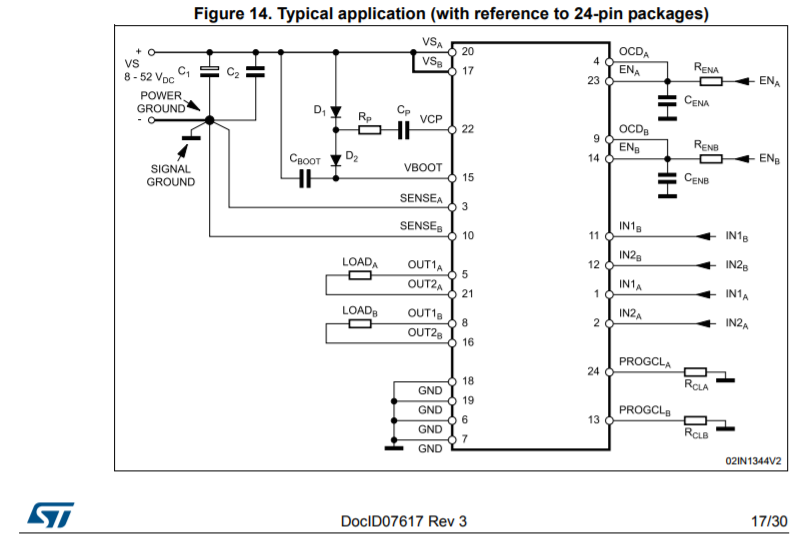

Also another idea - could it be that I am experiecing ground noise? From datasheet it seems shunt resistor should have very short ground path - see picture from datasheet? Please comment.

Ground noise generated by long sense paths is an high freq noise generated by commutation by inductive effects. If you sync in the middle of the ON time as described, you will sense the current far away from the peaks.

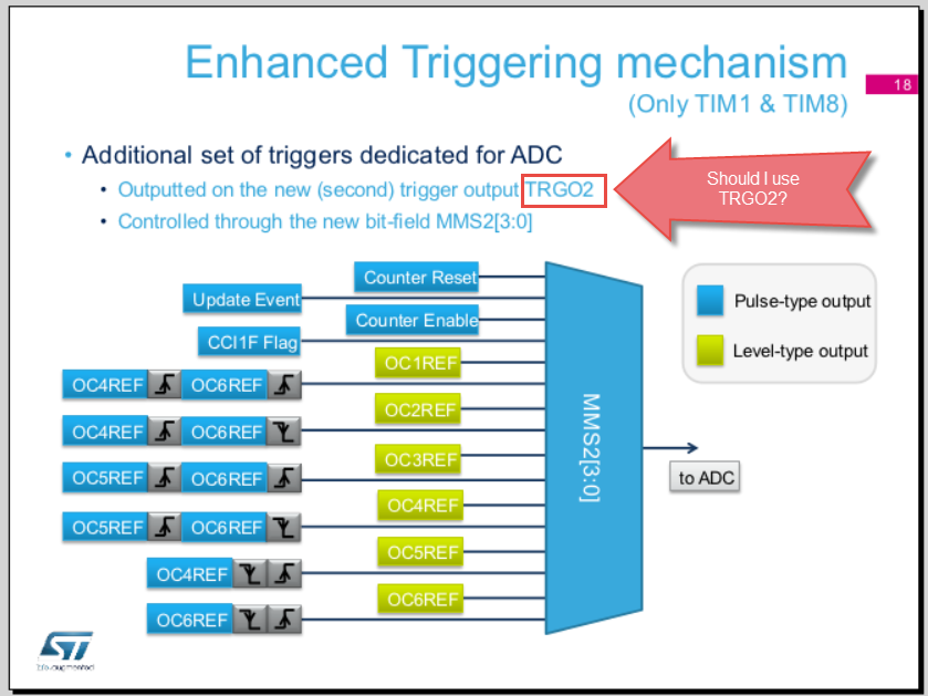

Another question - on some powerpoint slides I see this - so - should I use TRGO2 signal as adc input trigger?

2017-11-24 1:59 PM
using
sMasterConfig.MasterOutputTrigger = TIM_TRGO_UPDATE
completely breaks PWM operation.
I found out that i should indeed use trgo2update - as powerpoint presentation suggested - shown below.
sMasterConfig.MasterOutputTrigger = TIM_TRGO_RESET;
sMasterConfig.MasterOutputTrigger2 = TIM_TRGO2_UPDATE; sMasterConfig.MasterSlaveMode = TIM_MASTERSLAVEMODE_ENABLE; if (HAL_TIMEx_MasterConfigSynchronization(&htim1, &sMasterConfig) != HAL_OK) { Error_Handler(); }We’re moving the ST Community to a new platform to give you a better and more reliable community experience.
