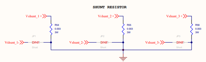

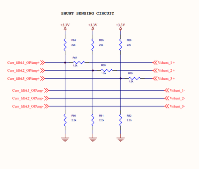

Shunt resistors: Replace 0.003Ω with 0.0012Ω to handle higher currents without saturating the op-amp or ADC range.

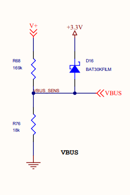

VBUS sensing: Adjust the voltage divider from 169k/18k to 655k/18k to ensure that the sensed VBUS voltage for 84V stays within 3.3V.
Are these changes electrically correct for reliable sensing in a 20S system?
Are there any additional component changes required (e.g., op-amp gain stages, filter caps, TVS diodes)?
