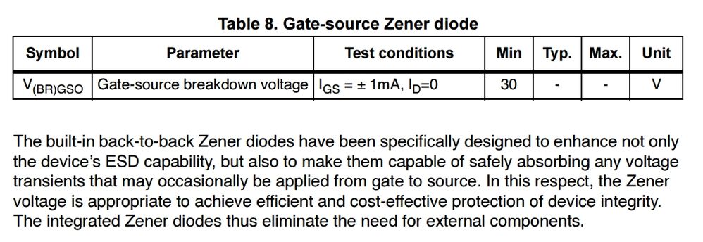

I want help to understand this.
The STM MOS FET STP6NK60ZFP has a MAX gate-source voltage (Vgs) at 30V. In order to protect it from ESD it has a built-in TVS diode. Over 30V it can fail. But the bulit-in TVS has breakdown voltage (Vbr) set at 30V. It's when it begins to conduct. The clamping voltage (Vcl) is a couple of volts more. It's when it conducts fully. But then it's over the limit 30V. More voltage than that can make the MOS FET fail. Shouldn't it be that the Vcl should be 30V so an ESD can't exceed 30V? Or is it really enough with Vbr at 30V and Vcl some volts more? Se table below.

Since you can and must rely on the information in the data sheet, your conclusion is absolutely correct. In most cases, a TVS with a lower voltage than the typical 30V is provided externally at the gate if protection is actually required.

>Or is there a certain tolerance above the 30V so the MOS FET can endure this anyway?
Sure, there is some margin , otherwise the internal 30V zener would be 100% useless.
But its not intended to "use" this 30V limiter for a circuit, its just some protection for handling the device,
until its soldered in the target circuit, where its gate drive voltage anyway is lower, in +/- 12 V range (about, typical).
So this kind of gate protection is just to get no damaged mosfets by someone touching the mosfet with some charge, until the final circuit is built.
Its some built in "insurance" to have a still working mosfet in the target circuit.

Really?
I get another impression when I read the data sheet:
The built-in back-to-back Zener diodes have specifically been designed to enhance not only the device’s
ESD capability, but also to make them safely absorb possible voltage transients that may occasionally be
applied from gate to source. In this respect the Zener voltage is appropriate to achieve an efficient and
cost-effective intervention to protect the device’s integrity. These integrated Zener diodes thus avoid the
usage of external components.
