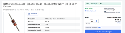

and still some STM diodes in old stock:  1480 STM diodes ...
https://www.conrad.de/de/p/stmicroelectronics-hf-schottky-diode-gleichrichter-1n5711-do-35-70-v-einzeln-155459.html
