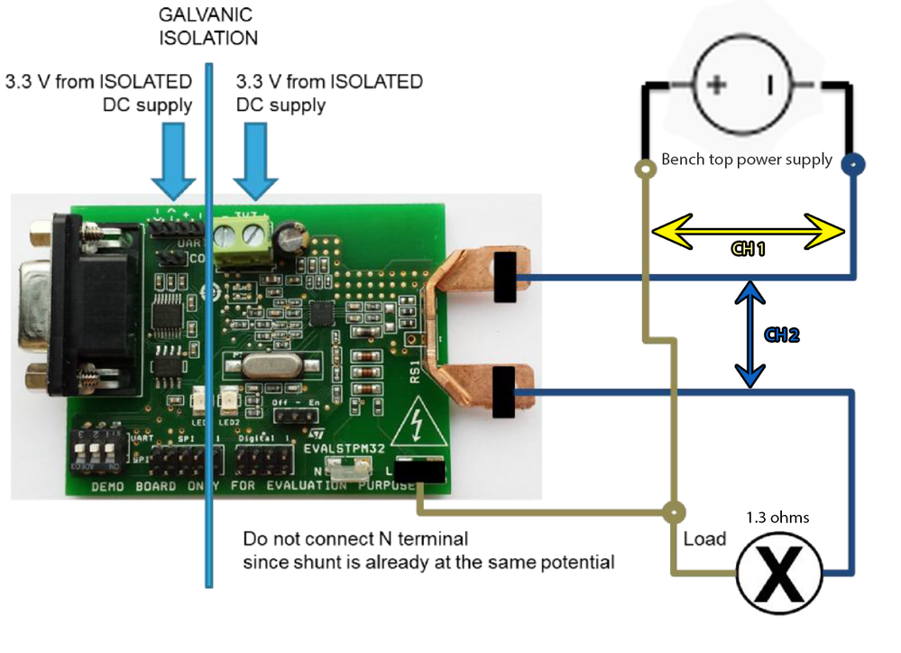

When I try to measure DC current/power/voltage, none of those values are captured. I am feeding 0.5 amps constant current into a 1.3 ohm load resistor rated for 10 watts. Here is my test apparatus:

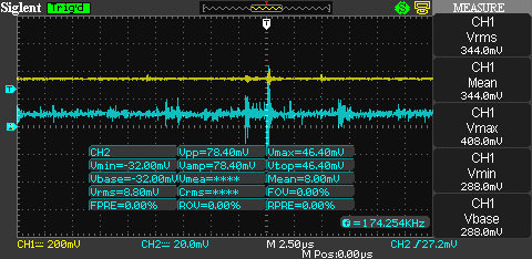

and here is what I captured on my oscilloscope (note CH1 and CH2 in above figure to understand which waveform I am measuring on each channel):

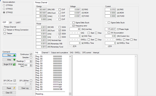

and here is the output to the evaluation board software:

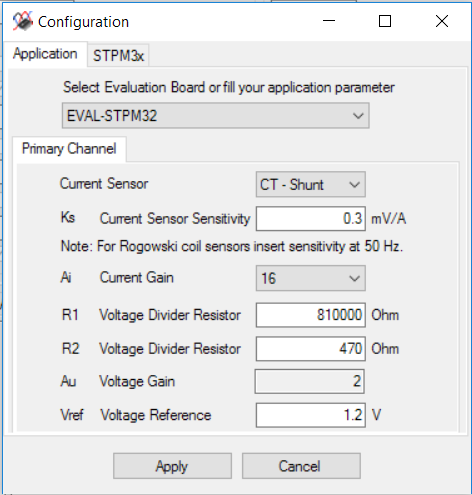

... and here is the configuration of the STPM32 while taking those measurements:
Seems like the current through the load and shunt resistor is varying wildly, despite being hooked up to a reliable benchtop power supply...
Has anyone got any ideas on what I'm doing wrong, and why the STPM32 isn't measuring the DC voltage and current correctly?
