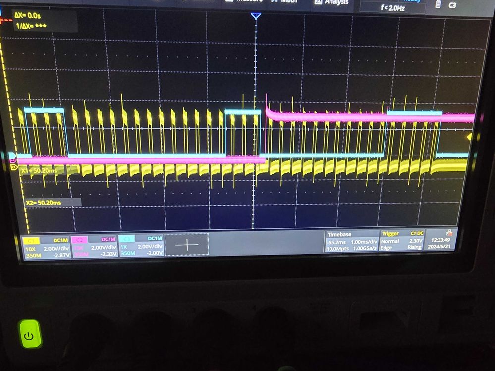

I included a scope shot for reference from the end of this first write
Yellow is Clock, Blue is LE, and Pink is SDI
0:0 writing 256 16bit values on SDI, all bytes are 0 except the last byte which is 0xFFFF
LE length is 256 16bit values, all 0 except the last 16 values.  The last is 5 and other 15 are 3
