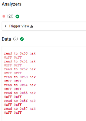

I made a capture of the I2C bus on the board which is below, followed by the WPSTUDIO (v 2.2.5) log file

On power up, or pressing the S1 reset switch I get the following on the I2C bus:
2024-05-02 11:51 PM
Hi
The log show I2C read is NAK and data is invalid 0xFF.
Seems ft260 dongle have some issues.
I suggest you change ft260 dongle
https://www.st.com/en/evaluation-tools/steval-usbi2cft.html
or other i2c devices, like STM32 MCU refer to this like
https://github.com/STwirelesscharger/STWBC86_NUCLEO_L476RG
2024-05-03 12:35 AM
I did some more testing.
I isolated the STM TX chip from the FT260 chip by removing the jumpers on P2.
I connected a bus pirate board to the I2C SDA/SCLK/GND (and set the 5V pull up on the bus pirate)
I then used the bus pirate to generate I2C traffic to the TX chip.
The TX chip still ACKed the write requests, but NACKed read requests, exactly the same as seen in the recording below where the FT260 chip was generating the I2C traffic.
When bus pirate scanned the address space for devices it found 0xc2 (0x61 write) but not the expected 0xc3 (0x61 read).
This indicates that the problem is with the TX chip, not the FT260 chip, and buying an FT260 dongle will not fix the problem.
It looks like the board is broken.

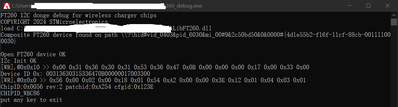

2024-06-27 7:37 AM
I have the same issue with the board (WBC86TX). The FT260 Debug Tool gives the following Output:
FT260 I2C donge debug for wireless charger chips
COPYRIGHT 2024 STMicroelectronics
load C:\Users\*******\AppData\Local\Temp\_MEI893602\LibFT260.dll
Composite FT260 device found on path \\?\hid#vid_0403&pid_6030&mi_00#7&353fbc31&0&0000#{4d1e55b2-f16f-11cf-88cb-001111000030}
Open FT260 device OK
I2c Init OK
[WR],@0x0x10 >> 0xFF 0x3F 0x3F 0x3F 0x7F 0x3F 0x7F 0x7F 0x1F 0x00 0x00 0x00 0x0F 0x00 0x1F 0x00
Device ID 0x: FF3F3F3F7F3F7F7F1F0000000F001F00
[WR],@0x0x0 >> 0xFF 0x00 0x03 0x00 0x1F 0x01 0x7F 0x1F 0x00 0x00 0x0F 0x1F 0x01 0x07 0x03 0x01
ChipID:0x00FF rev:3 patchid:0x1F7F cfgid:0x1F0F
[ERR] chipid 0xFF
put any key to exit
According to my Logic Analyzer, the Board seems ACK "ADDR+W" but NAK "ADDR+R". So is there any state
possible in which the chip does not respond to a read request?
2024-06-27 8:01 AM
Hi
Seem your board have some issues, please try "wlc_ft260_Recovery.7z" at this link
Wireless Charging solution Wiki - STMicroelectronics Community

2024-06-28 12:39 AM
Hi
Do you try many time and get same results "read chipid 0xFF version 255"
If yes, this mean can not read chipid and chip is broken, suggest you change chip or boards.
