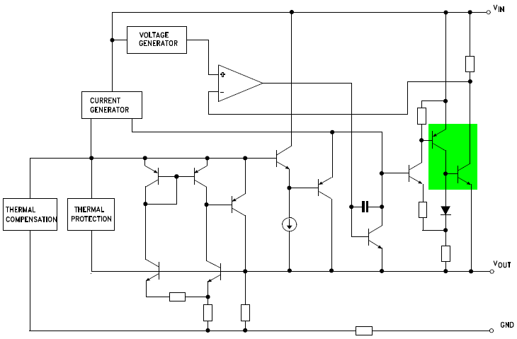

In fact, the LD1117 is also partly based on this technology and is using a pnp and npn, which is why it is also called a quasi-LDO:
