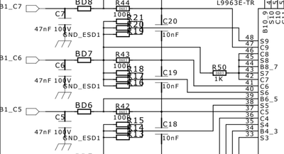

What is causing this? I think I have the unused pins connected correctly in the schematic (see below). Unused pins are shorted together and connected to the lower cell through 1k resistor, as instructed in the datasheet.

This is the relevant part of the schematic. Datasheet says:
◦ Unused pins must be first shorted together to eliminate differential noise
◦ Shorted traces must be connected to the PCB connector of the lower mounted cell, through a 1 kΩ resistor
However, there seems to be some leakage current involved. I measured 46mV over the 1k resistor. VCell9 voltage is measured between C9 and C8 pins, which now shows 46mV too little.
I removed the 1k resistor and shorted the unused pins directly to C6. I'm now getting exactly correct results and haven't noticed any ill effects. Is there any particular reason for the advice to use 1k resistor? I assume it would work for every other pin, but in my opinion C8 and C6 must be tied directly together for the voltage measurement to work.

I have nearly all diagnostic features enabled. I noticed this bit on cell open wire diagnostic:
"Diagnostic is present just on enabled cells (VCELLx_EN = 1). The mechanism used for this detection is based on a diagnostic pull down current (IOPEN_DIAG_CX), which allows to measure the voltage drop generated on the external RLPF resistance connected in series to Cx pin."
And IOPEN_DIAG_CX is defined as 40-60uA, 50uA typical. Now if C6 pin has 50uA pulldown but C8 doesn't (because VCELL8_EN=0), doesn't this create exactly the ~50uA current draw over the 1k resistor I'm seeing?
