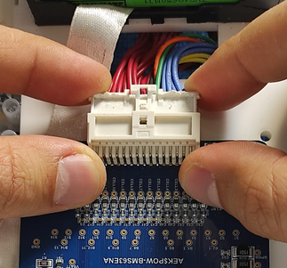

Note: Sometimes, even with the jumpers, this problem happens. That's because the BMS connector is not inserted correctly. Try to reconnect it by pushing along the borders, uniformly, as in the picture:

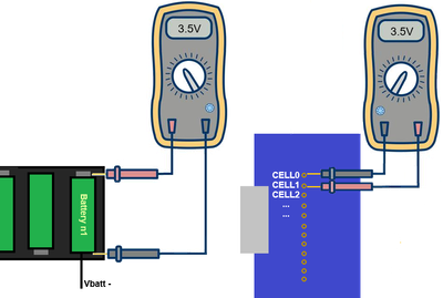

To check if the measurement are right I suggest to compare voltages as in the picture:

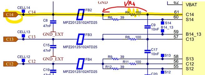

If you look at the scheme present on the UM you should notice the presence of 100 Ohm resistors between Battery contacts and L9963E/F's Cx pins. Using RLPF is the proper way to connect battery cells to the AFE.
You may find the application scheme on L9963E device datasheet.
You may check this VR4 voltages. If this is not zero, the voltage perceived by every Cx pin is reduced by a little bit. But the device handles it. Take a look to L9963E datasheet to understand more
Best regards,

I am reasonably familiar with the schematics, and those RLPF resistors should not impact the voltage reading. There is no meaningful current on the voltage reading pins Cx, only the balancing pins Sx/Bx_x.
Confirmed by measuring over the ESD capacitors. Measuring cell C13 gives 3.90V, measuring over the ESD capacitor between C12-C13 pins (component C17 on the eval board) gives 3.89V. But the reading from L9963E is 3.78V. And the same pattern for all cells. And the same offset with or without balancing active for the cell.
Just noticed the a similar offset is also seen for VTREF. Measuring on the board gives 4.96V but the reported value is 4.81V.
