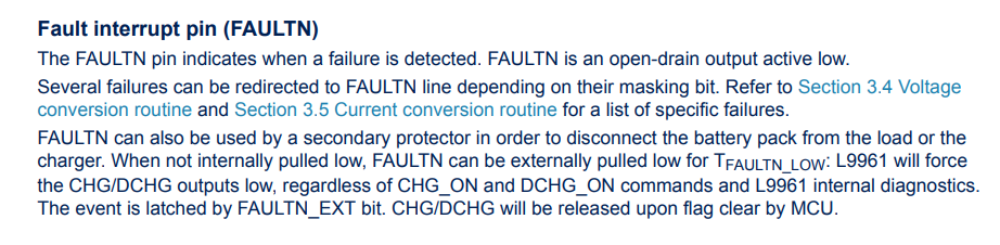

I am working with the L9961 IC for battery management, and I have a question regarding how the charging (CHG) and discharging (DCHG) FETs are turned on or off when faults occur.
From the datasheet, I understand that:
My question is:
