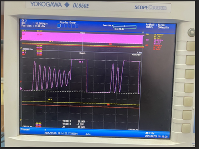

I have also attached waveform across the diode D37.(During healthy condition)
Yellow- Vin=24V, Red- Vout=-15V, Pink- D37.
From this much ringing across D37 we inferred that inductor is running in discontinuous mode (also note that this is a condition where load is minimum).

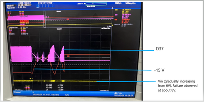

Also, please see waveform of failure.

Yes having a short circuit between pin 13/14 and 16 could indicate an over voltage condition.
Using the L7987L as "normal" step down converter is less demanding on the DC/DC converter chip (max. voltage on the switch is Vin + Vdiode), while using the DC/DC as inverter will generate a much higher voltage on the switch (Vin + Vout + Vdiode)
I have noticed that You are using a Datarecoder, what is the bandwidth of the Chanel You are using to measure the Voltage over D37, could it be that you don’t capture a fast negative spike?
2025-03-02 8:27 PM
I am using Yokogawa DL850E (BW is 2MHz).

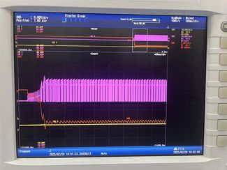

From your suggestion, I have changed diode to schottky, IC failure is not observed but still output is not as smooth as desired. (Red is -15V, Pink across Diode). I believe this is compensation issue

Happy to hear that you have no failure.
Yes probably you have to tune the compensation cirquit.
I would ad a (ceramic) low ESR capacitor in parallel to C103.
Checking against the application note in https://www.st.com/resource/en/datasheet/l7987l.pdf, You don't have the RC lowpass filter on pin 4 (VCC), please verify that Your input voltage is clean (against IC_GND and GND).
