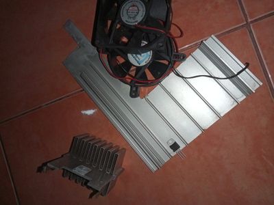

Why using a fixed 8V reg for a 19V supply ?
You have planned the cooling ? (need a big heatsink, + fan probably )

Actually what you've designed is a big heater with an annoyingly bright lamp.
