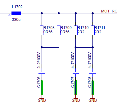

Each line of the supply has a filter (left side is driver side, right side is to the motor):
Motor filter (each line)

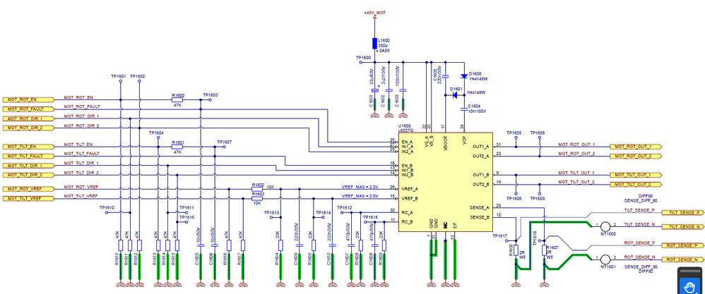

The driver is used for two identical motors. As described in my inital post, we start pulling the EN_x to high. The same we do with the VREF_x. The we apply e.g. a PWM with 100 kHz and a duty cycle of 30% to the IN1_x and a low signal to the IN2_x to move the motor forward.

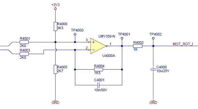

In our application we want to measure the current flowing through the motor to recognize any brake or blockage to turn it off by software. Therefore the following circuit is implemented and connected to the Kelvin connections on the shunts in the picture above. The function is: 1,5 volts per 1 ampere with an offset of 1,485 volts.
Current measurement
We expected to measure a linear depency between current through the motor and the voltage on "MOT_ROT_I" (cleaned by offset).

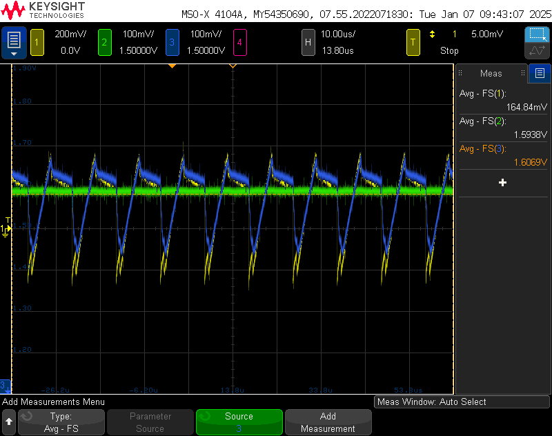

Yellow is measured on TP1618 (i.e. SENSE_A pin), blue is TP4001, green is TP TP4002. The confusing signal is the one on the shunt: it shows a quite large peak of current flowing into the "wrong" direction. This picture was taken with duty cycle = 20%.

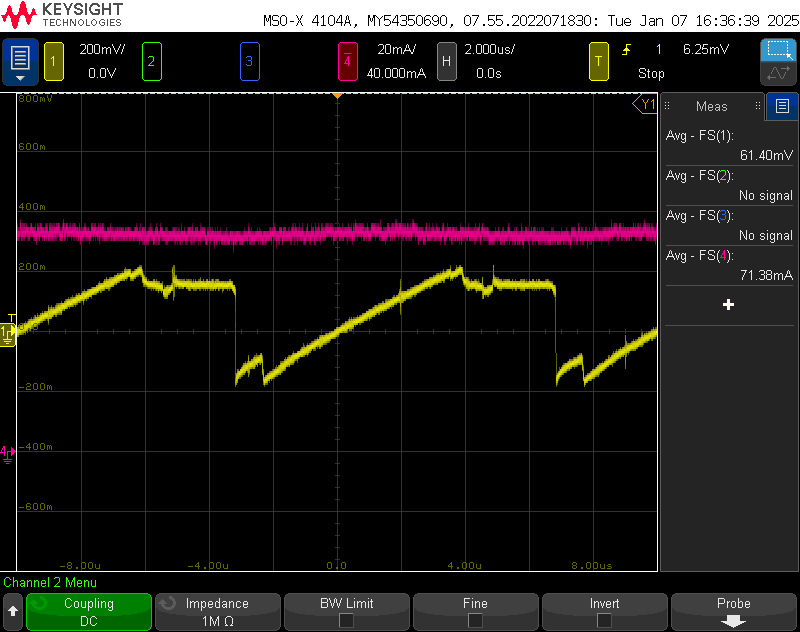

The next screenshot shows the current into the motor (after filtering, filter works really nice, no rise or fall of current) taken with a current clamp (red signal). The yellow signal is the shunt again, this time the duty cycle was 10%.
